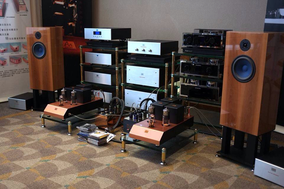

Отправлено 18 September 2018 - 18:51
https://www.hi-fi.ru.../detail/1077071
b00dff2cd0a9a58e2c54e8465bf959571681937a
