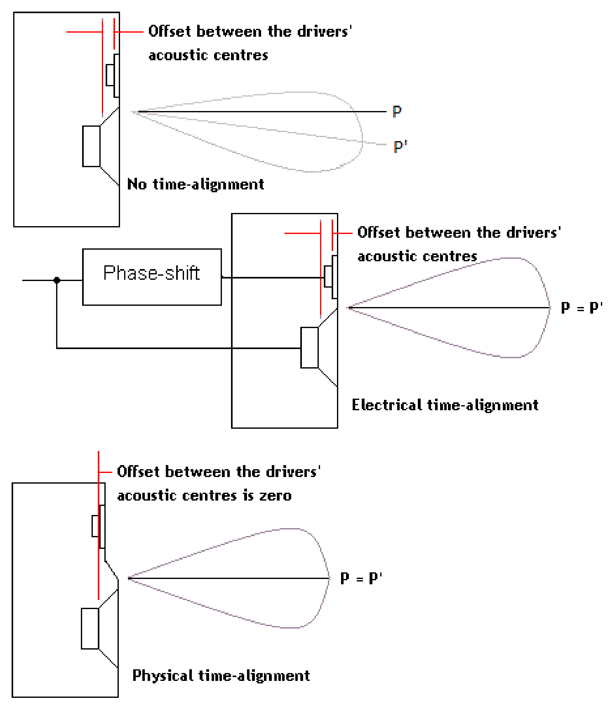

Для Яши
tm-lobe-methods.gif?content-type=image%2
